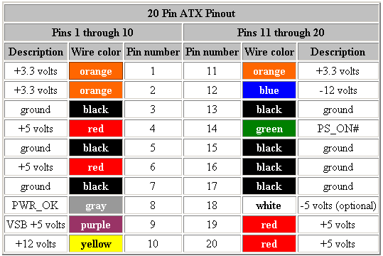

Por lo que veo tendrias que puentear el amarillo para los pines 13,14 y 15, el rojo para los 7,8 y 9 y masa para 4,5,6,10,11 y 12
Y el problema seria que a ve de donde sacas sin tocar el conector atx de la fuente o la placa los 3.3V del pin 1, 2 y 3
Para sacarlos de la fuente sin tocar placa deberia de ser de los cables naraja del conector atx
http://1.bp.blogspot.com/_0Zl5fIJCb54/S641TIugC8I/AAAAAAAAAE8/jnoml0vY5eo/s1600/20+Pin+ATX+Pinout.gif | |

| Segun entiendo los pines 1,2,y3 son opcionales o sea que no son necesarios para lo que necesito ya que tiran +3.3 voltios.
Pins 1, 2, and 3 are optional as well, as evidenced by some adapter cables that connect the drives to older PSUs. These are usually Y-adapters that have the four-pin drive connector on the other end. Currently, SATA drives rarely use 3.3 volts. That may be because there are too many people using adapters so the drive makers don't want the headaches which come with using 3.3 volts. But in the future, 3.3 volt drives may become common so you need to be careful when using SATA power cables which don't implement 3.3 volts. | |
